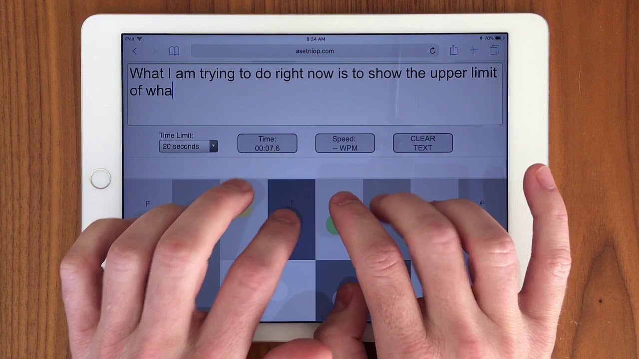

For those that do not know about ASETNIOP here is a link that will give you a good impression;https://www.reddit.com/r/MechanicalKeyboards/comments/hltqdt/touchtyping_on_10key_ginny_after_3hrs_of_asetniop/
I checked and a 10 key ginny is quite affordable, but I would like to give it a test drive before commiting. If possible I’d like an extra layer on my keyboard I can switch to and use ASETNIOP.
Have other people looked at ASETNIOP?
I can alter an existing sketch to add minor functionality to my keyboards but porting the ASETNIOP engine is well above my skill level. Some suggestions on how to get started with ASETNIOP would be great.

As for speed, they make some interisting claims;
The full ASETNIOP standard doesnt just use chords for letters but also entire words, but I am also scepticall, thats why I’d like to try it on one of my Kaleidoscope powered keyboards before splurging money on another novelty.
If they’re using chords for words à la stenography, speed claims are more credible. But just because someone can type extremely fast on a given input device doesn’t mean much. Measuring outliers isn’t very useful.
