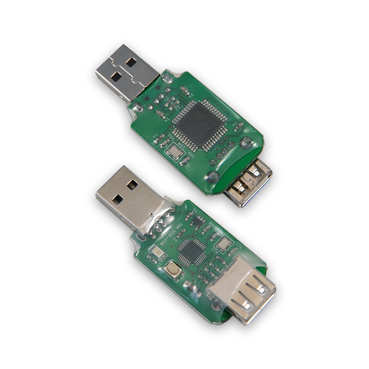

I thought about buying this some years ago, before I went with programmable keyboards:
