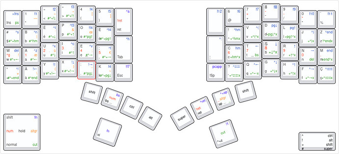

This my current bépo layout (I made a lot of changes since my previous post one year and half with the experience of using it).
All the explanations (a long text) why I did it like that are available here, some stuffs I tried but it was not successful, it can help you to improve your personal layout.
There is also a quick explanation of my kind of vi mode if some are interested.
Don’t hesitate if you have any questions.
The last version of the layout for the future.
