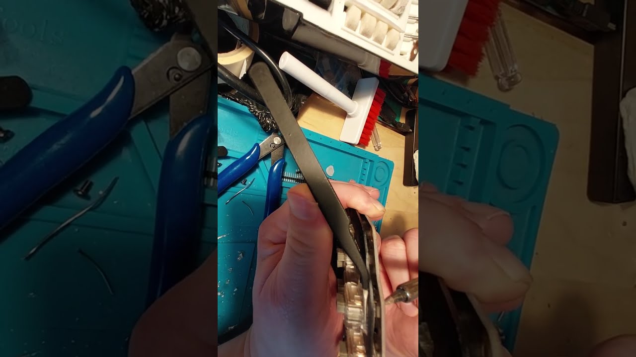

So the general idea is:
  1. Melt the solder with an iron and whilst it is still in contact, use a solder sucker at 45 degrees to suck. Try to get most out, so you can see the pads and pins, but it’s not vital to get all
  2. Hold the board vertical and apply the iron to pins whilst leveraging with some curved needle nose tweezers (sharpest you can get) levered under the flaps of the switch.
  3. Keep holding the iron on alternate pins whilst applying some leavering force. Eventually it will pop out
I found a video of me doing it. The trick is to get really pointy tweezers so they can be pushed under the flaps. Do this AFTER using a solder sucker to suck out most of the solder
I am sure there are better tools/techniques than this but this is using what I had around (the tweezers were in a generic ‘mobile repair kit’ off amazon that had loads of screwdriver pieces. Although I didn’t damage any of the pads, it could easily do so if you put too much pressure on the tweezers.
You can hear the 4 clicks as I desolder the pins. Thinking about it now, I think the clicking sound is coming from those 4 corner clips that hold it in place.
