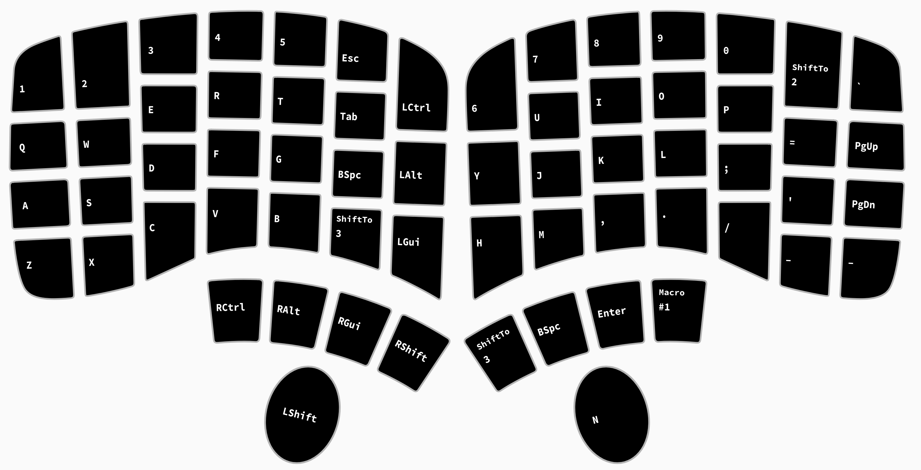

When I flash that, the Colemak layer is all wrong. See this screenshot from Chrysalis:
So it’s not the Colemak layer, it’s the qwerty layer, with every key shifted 1 to the left. Very weird.
I see… This somehow got messed up in Chrysalis, and now that layout is flashed to EEPROM?
How can I fall-back to what’s set in the firmware?
You can go to “Keyboard Settings”, expand the “Advanced” section, and there will be a button there to clear EEPROM. With a clear EEPROM, the firmware will fall back to what was compiled in.
