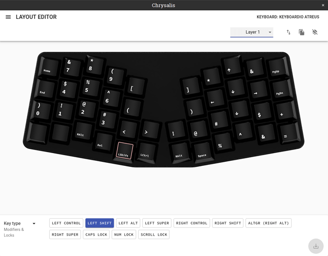

I’ve only had my Atreus for a few days. But my layout - fully custom - “moves” the bottom-row modifiers to dual-use keys on the bottom row of my QWERTY layout. This means I get a “Z” when I tap the Z key, but if I hold it, it serves as the Left Ctrl. X is LSHIFT, V is LALT. Likewise on the other side, with M, period, and / also serving as RALT, RSHIFT, and RCTRL, respectively. I also do this on most of my other layers.
However, I’ve also realized that I’m finally comfortable giving-up my Caps Lock key by having a dedicated Shift key under my thumb. So the key below B is a full-time Shift key. I use the dual-use keys only for shortcuts. (I’m a heavy user of AutoHotKey, and a computer programmer.)

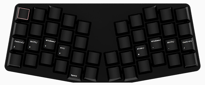

Layer 0 - The Base Layer
  • QWERTY works for me, to the tune of >90 WPM.
  • Here you’ll see the first “key cluster” that I’ve preserved: The modifiers that are usually on the bottom row of a normal keyboard are now available as dual-role keys in the Z…/ row. This lets me use muscle memory for almost all my keyboard shortcuts - future-proof and still portable - with little modification. The fact that the CTRL keys are “outboard” of the Shift keys here is due to my habit if holding CTRL with my little finger and Shift with my ring finger when hitting CTRL+Shift+X combinations.
  • I don’t use the left-most two characters and the right-most three characters on the bottom row at all. I have Backspace mapped onto Layer 1. These keys are here just in case my wife needs to use this keyboard.
  • I also don’t use the backslash key on this layer. I had it mapped to Layer 1 on my last keyboard (an original X-Bows), and I continue to use that mapping.

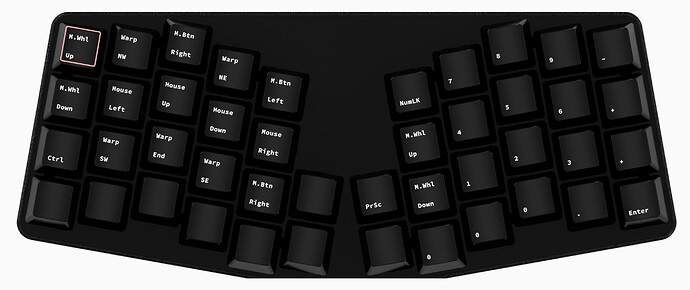

Layer 2 - Numpad and Mouse
  • My dad is an accountant, so of course I learned how to use a number pad at an early age. And fun fact: You can auto-resize columns in Windows Explorer’s “Details” view by hitting CTRL+Num5.
  • I’m learning the mouse nav keys just now, as the Atreus is the first keyboard I’ve owned to give me this option. Liking the mouse warp so far, though I hear it doesn’t help as much with multiple monitors.

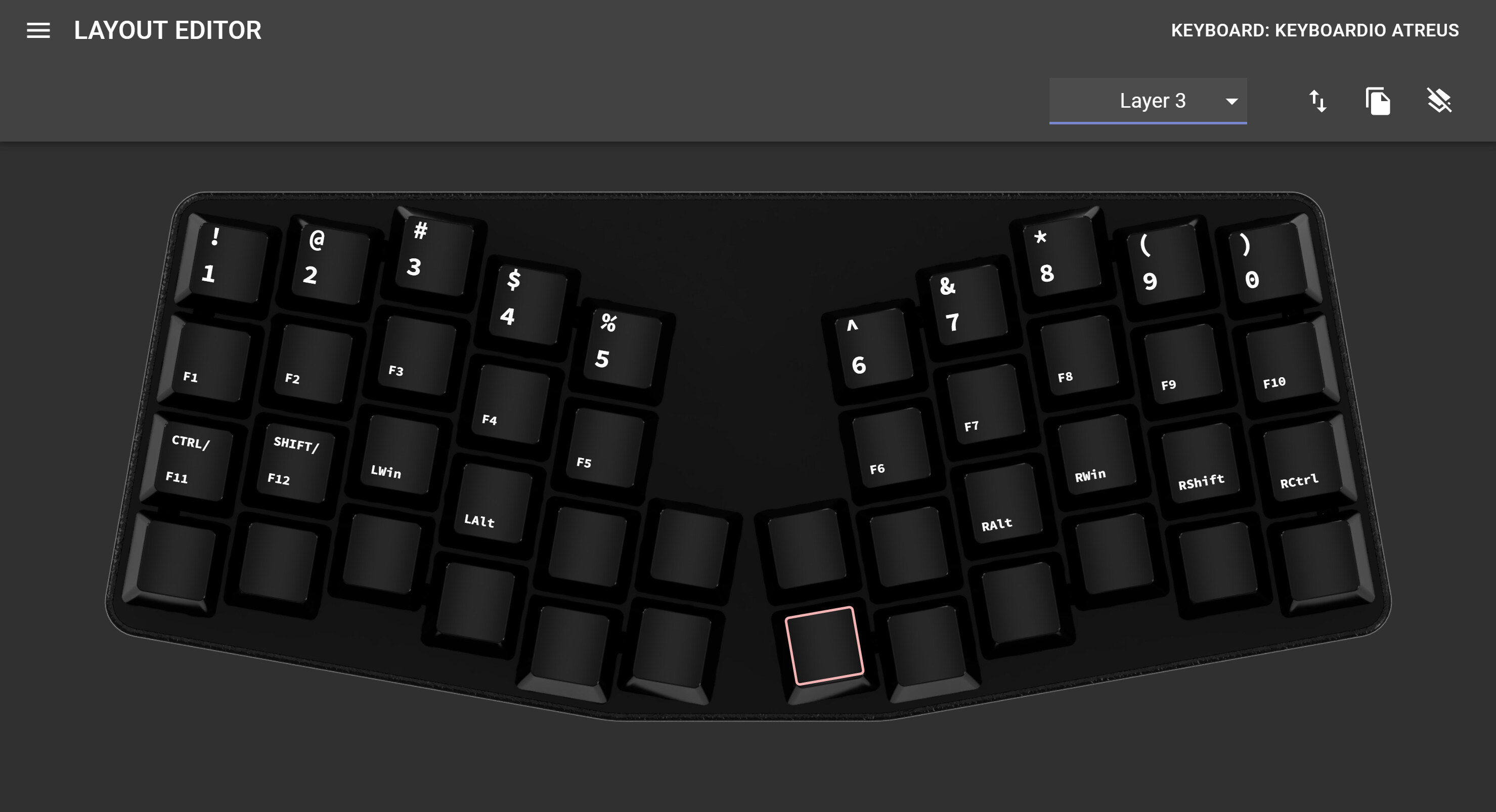

Layer 3 - Numbers and Fn Keys
  • This layer lets me reach the number keys - and, with a Shift combo, the symbols above them - as I have for years.
  • Note that my modifiers are consistently available on the row below the home row. Muscle memory is important to me.
