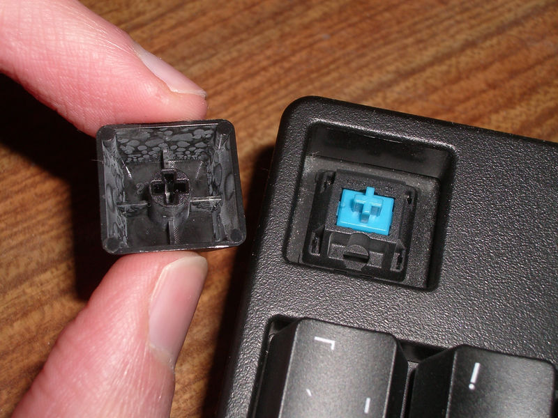

The Atreus (from Keyboardio Kickstarter campaign) use CherryMX mounts, so the keycaps must have this “crossed” mount system :
XDA is the profile of the keycap :
