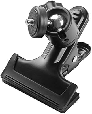

For a quick solution I’m trying these clamps:
Seem sturdy enough (ordered one just to see, got another 2 on order)… will have to be ‘above’ table. I ordered the 3rd and a little iPhone holder https://www.amazon.co.uk/gp/product/B06ZZMXGK9/ to try use my iPhone as a track pad: using http://mobilemouse.com/ - clamped to the keyboardio as thats the biggest annoyance for me so far… having to loose touch with the keyboard.
