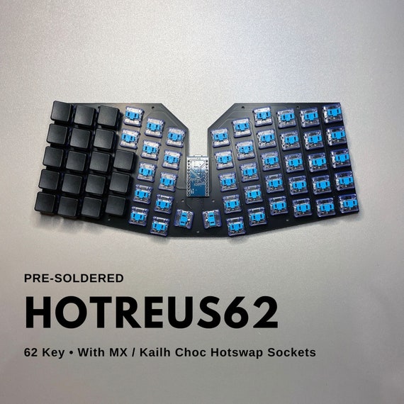

Good news my friends! So I’ve been drooling for a low-pro Atreus62 for bout the past 4-5 years since my Atreus62 has been my daily driver and Choc incompatibility + I don’t know how to design PCB’s yada yada.
Behold!
Now I’m just working out a case/keycap situation and ordering the rest of the bits but it’s now at least POSSIBLE to kit together a low profile Atreus62 :raised_hands:
