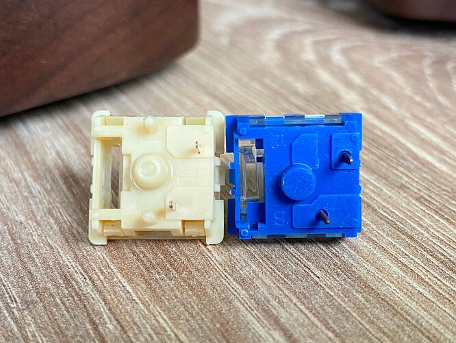

After my Model01s dying and restarting the search for a ergonomic keyboard for the next 10 years, I ended up with a Model 100 (which arrived today). However, I did find that I prefer low-profile switches over the normal profiles of MX switches (and lower actuation force).
There currently are 2 key switches that have the same (5 pin) MX pins as normal MX switches:
  • Tecsee Pudding Medium
  • Outemu MX Low-Profile
So when I ordered my Model 100 I took the plunge and also ordered 70 Tecsee Pudding Medium switches. And they are indeed MX pin compatabli and they work!
I really like the feel of these, it is noticeably easier to type.
Here are some photos:
Comparing the key switches
Height difference between normal and medium profile keyswitches
I’ll report back how they feel once I’ve had time to properly type on the Model 100 (I’m currently on leave because of the birth of our third child)

I have! They are hit or miss because the center pole is thicker:
Important to note that while KS-33B fit standard MX sockets, they have a 4.5mm center pole. They won’t fit existing MX PCBs unless the design also supported other low profile switches with larger center holes like Choc v2 or KS-33.
