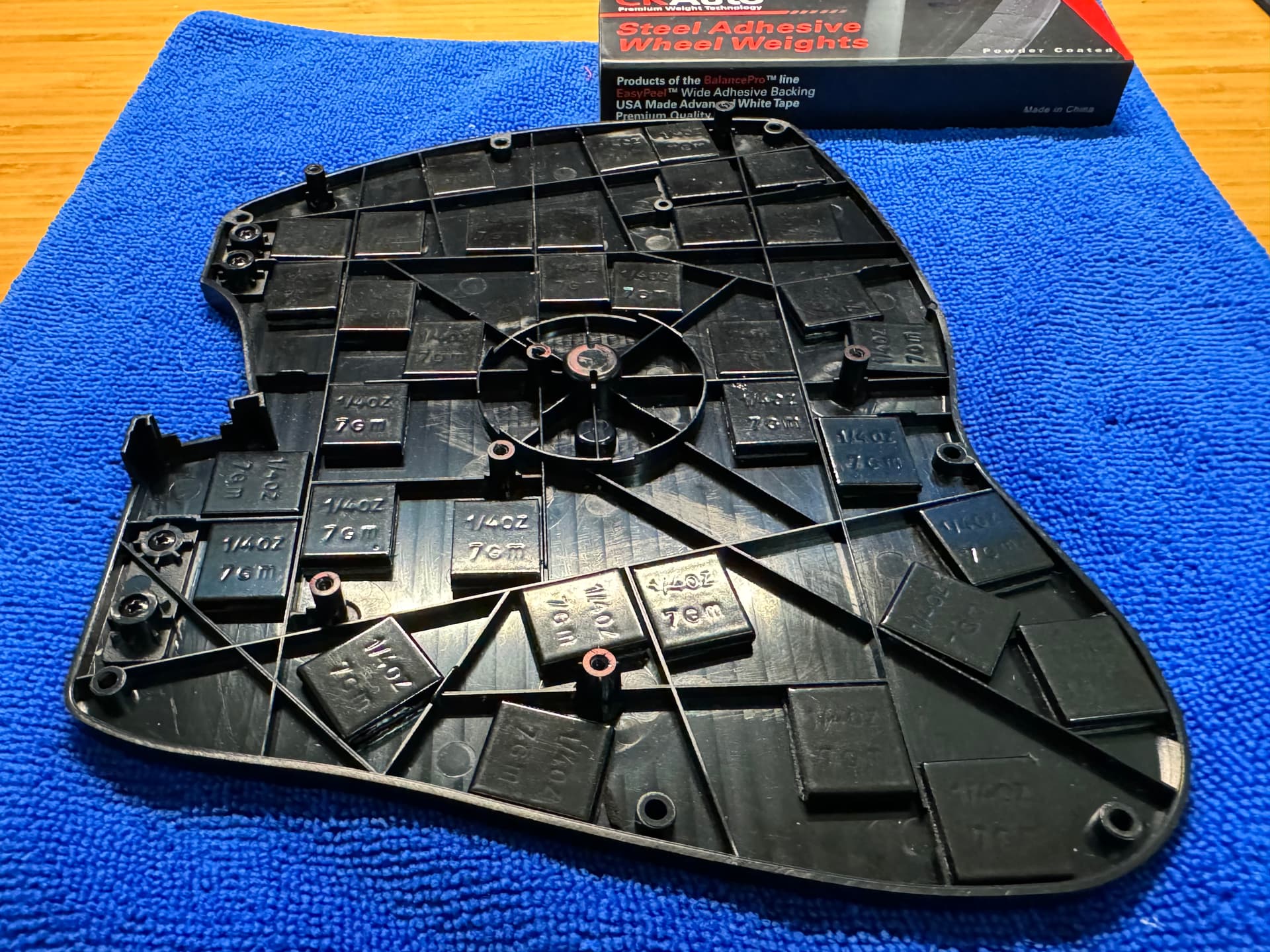

Weight Mod
The Model 100 is so light, that it often slides and moves with regular use on my desk. I recently bought a Rainy75 for work, and I really like the weight to keep it grounded, but also thought it might have some effect on the sound.
I ordered these small adhesive Auto weights from Amazon which are about $9 per 48 weights so I bought 2 boxes. I ended up using 35 weights per keyboard side. I opened the case then just put them where I could fit them on the base plate. The adhesive is like foam adhesive, so it’s best to place is correctly once as ripping it off will tear the foam. It might still stick, but some of the foam will come off. I like the foam as it probably prevents any rattling between the metal (even with the coating) and the coating I think makes them non conductive too (at least one reviewer says so).
This resulted in each side being around 1250 g (or 2 lb 12 oz) each. They feel way more stable and another side effect is they kind of feel more premium. The benefit of these weights is you can make it as heavy as you want by deciding how many weights to use.
