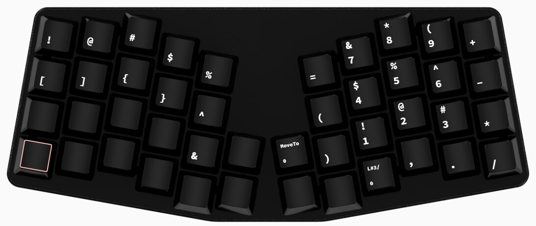

Layer 1: Numbers and Symbols
Layer 1 is focused upon creating a great numeric pad using just the right hand. Note that I have everything I need here in order to create full arithmetic expresssions here, including parens. The left hand contains easier access to the symbols above the numbers, and brackets. Note that I very explicitly did not overwrrite the characters Z,X,C, and V, as I wanted them to work seamlessly with Ctrl.
